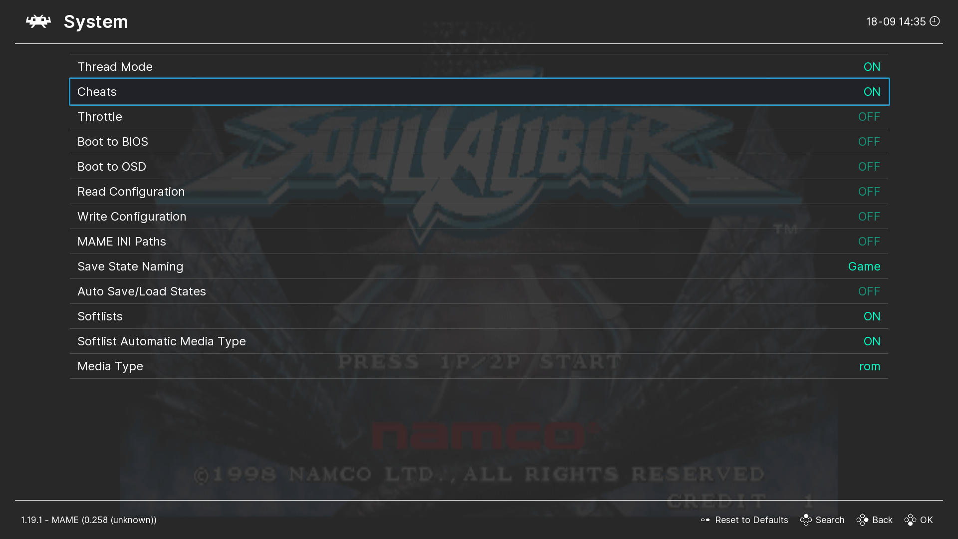

HOTKEY + B.Core Options → System category.Cheats option to enabled (it is disabled by default).

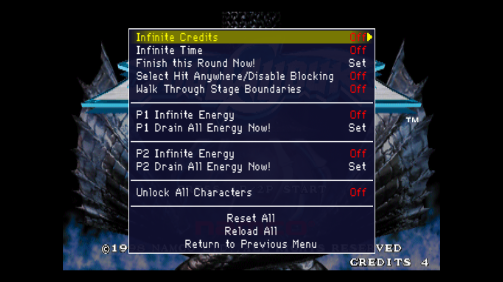

Once the game has restarted, open MAME's internal menu with SELECT + Y, then enter Cheat. You will find the list of codes available for the current game: turn on the ones you want, go back to the game, done.

If the Cheat entry does not show up in the MAME menu, either the Cheats option is not enabled or cheat.7z is not in the right place: go back over the two previous steps.
